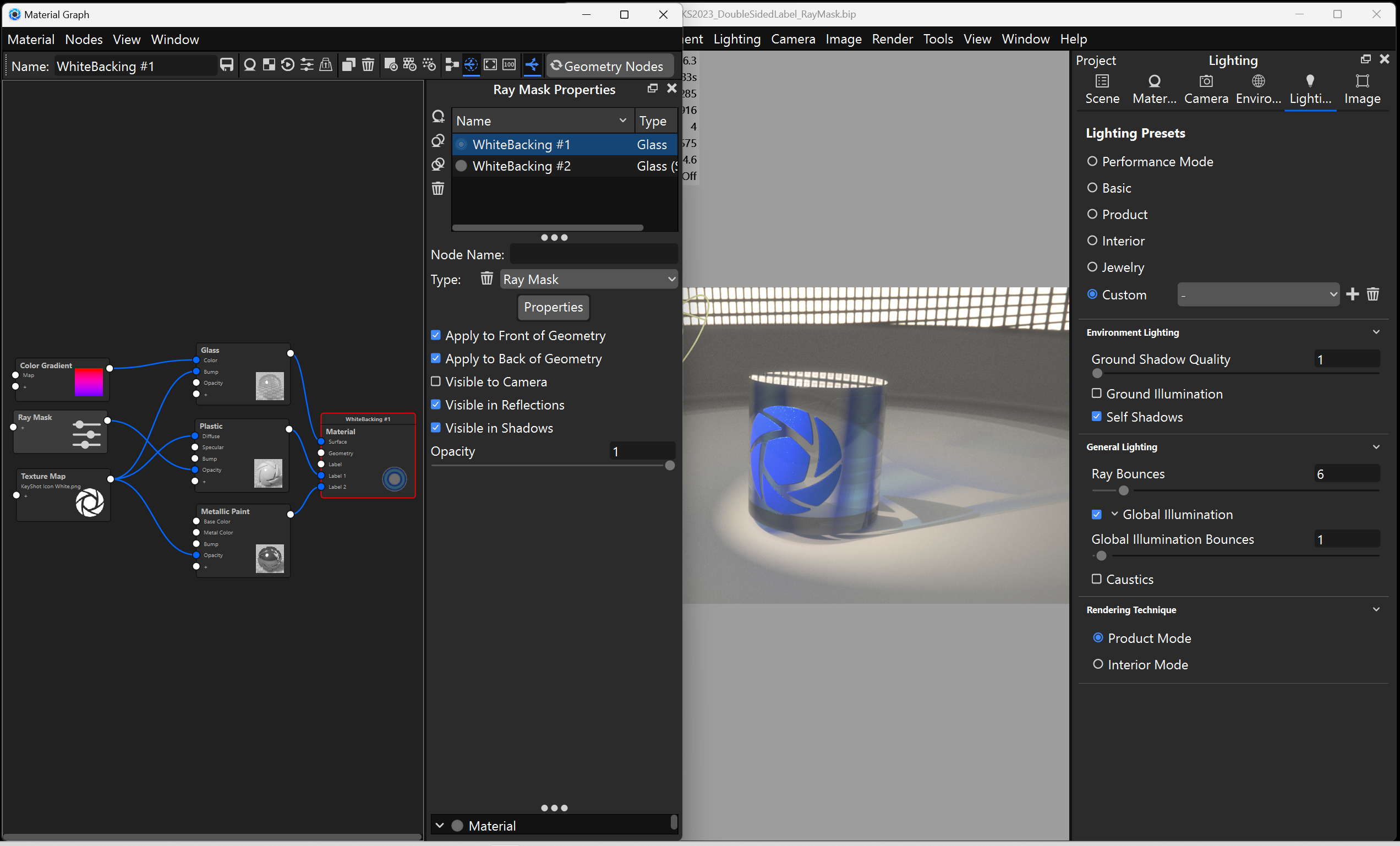

You can enable ray mask with little edit of the config file - it was present as a hidden beta-feature.
How do you have the label applied? If you are using Planar projection, you can use the depth slider to adjust the depth the label goes.
Otherwise, you can use the Occlusion Texture tied to the Opacity of the label node to make it so the double doesn’t appear and you won’t see it from the back.
If I’m right the ray mask node passed the test and is now visible for all, at the bottom of the node utilities if I’m correct.
yes, just not sure if it happens during the version 10 lifecycle or later…
With experimental features activated you can use ray mask like in the latest release, but only in CPU mode.

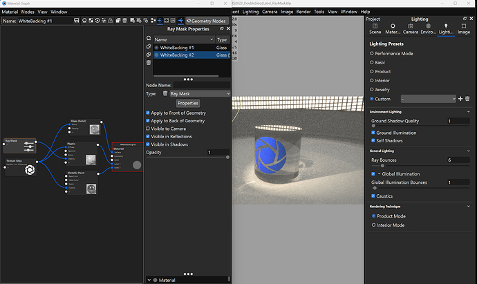

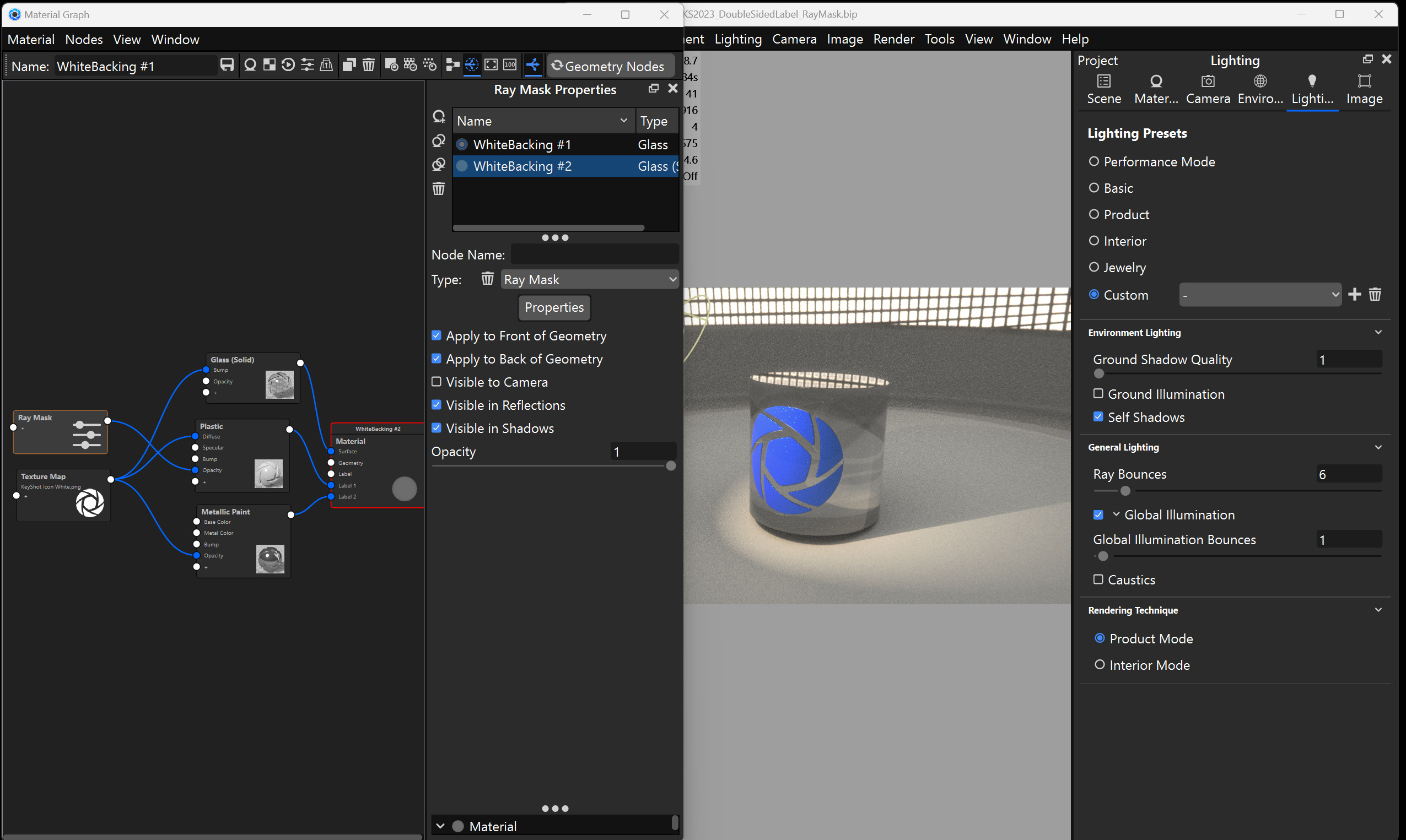

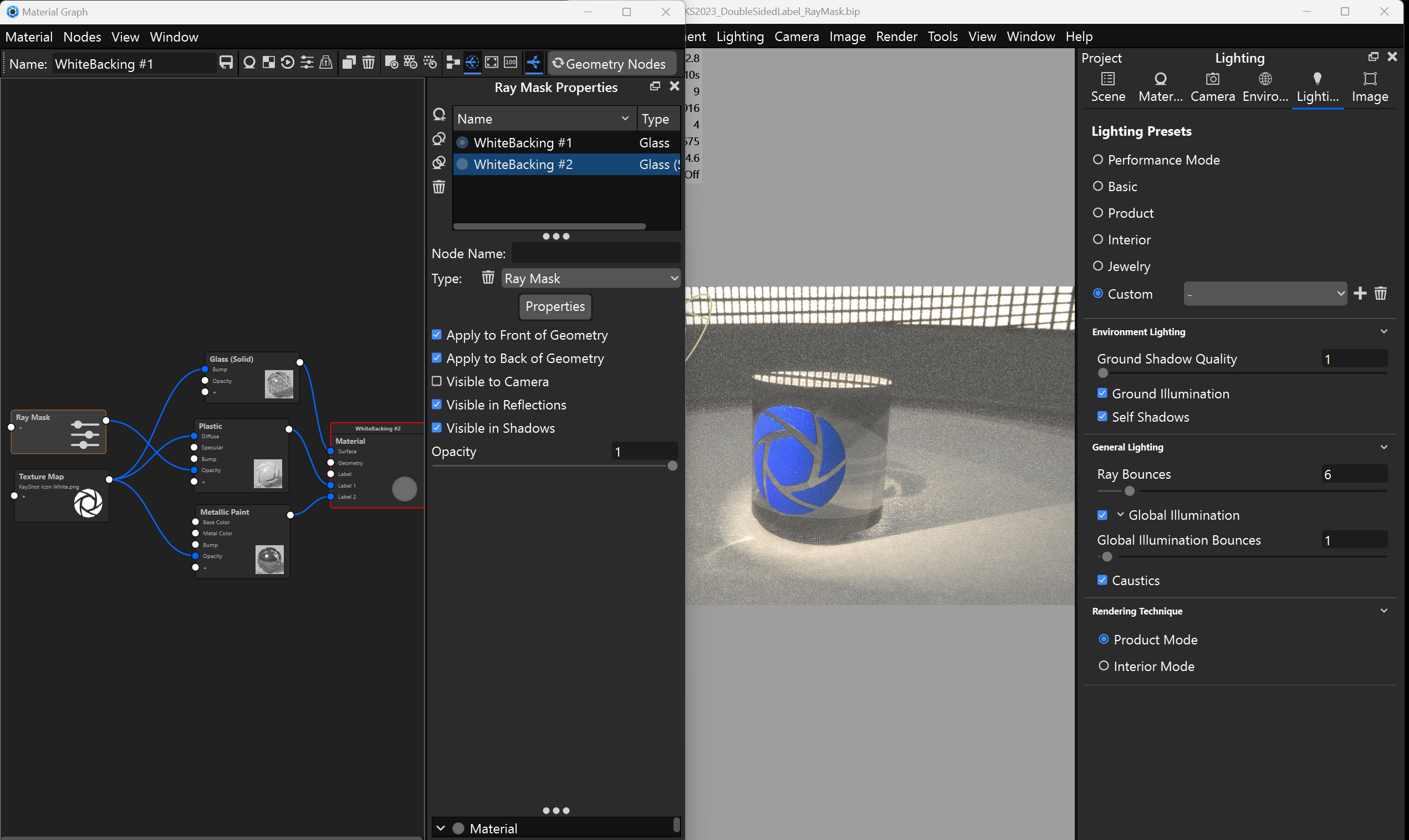

How did you get the label to show up and cast a shadow? Surprisingly I can’t seem to find any information on it, or maybe I’m not looking in the right place.
It depends on the material and settings. The scene from the screenshot was using the “Glass” Material. If you’re using a Solid Glass or another transparent material adjust the transparency distance and enable caustics.
